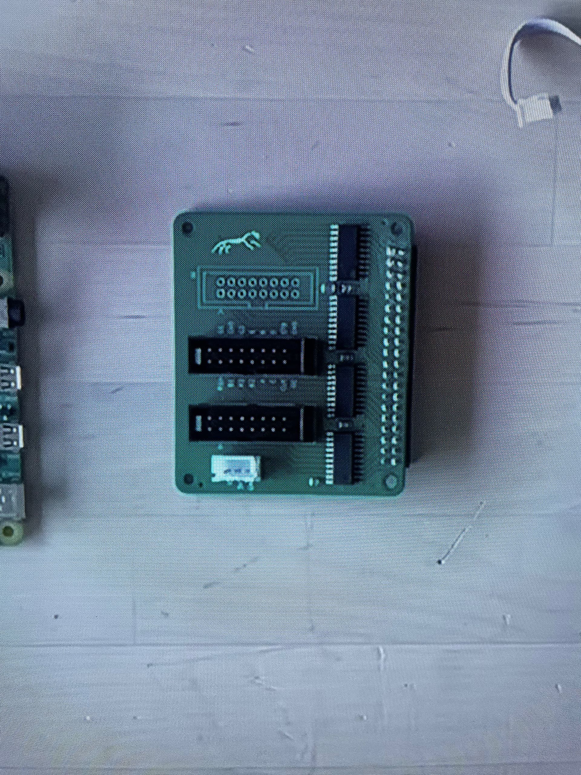

Does anyone know what Hub75 matrix this is?
I’m just curious if anyone is able to tell me what this hub75 matrix interface is. I can’t recognize the logo on it but I’m building ancient James’ exact volumetric display. Any help would be greatly appreciated!
You asking about a PCB on the second photo?
It looks like a simple connection board between Raspberry 50 pin and a standard HUB75 2*8 connector. The chips on the PCB are likely a buffers.
Yeah I was wondering if he got it custom made or if that is a manufactured interface from a brand that someone was able to recognize bc of that logo. Thank you!
never seen it, but honestly with the electrodragon 3 board that we all use and costs a few dollars, interest in other boards that tend to cost more and don’t do more, is about below 0 :slight_smile:
