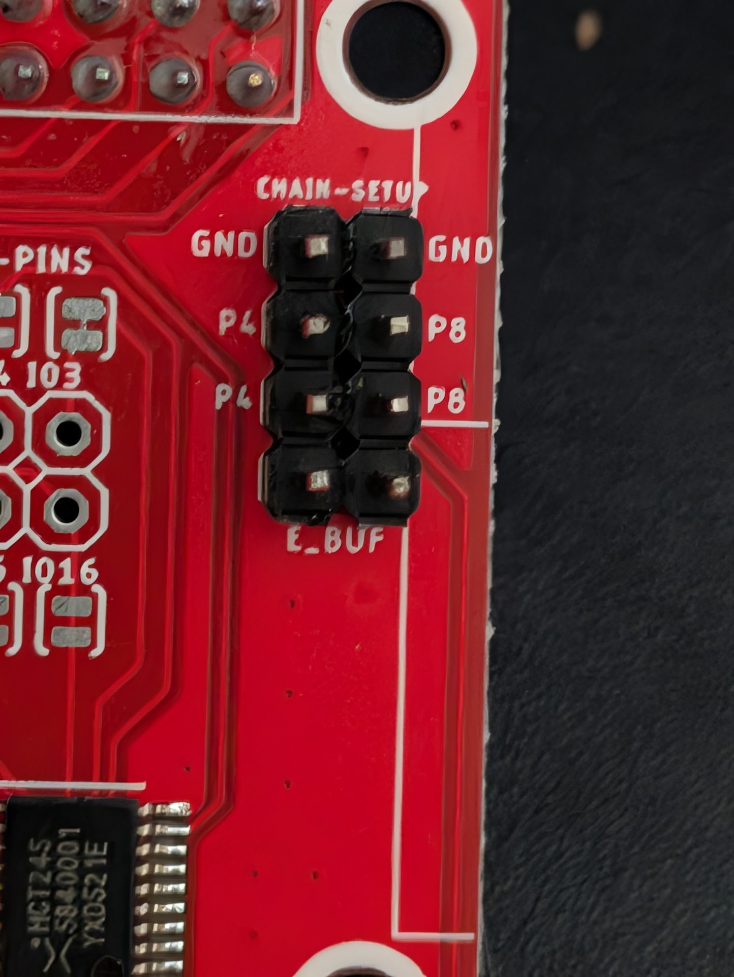

I picked up the Pi hat board from electrodragon. I’m having some issues driving it (Using a Pi3 B+)

I have also found out that it looks like I need to set the E line because it is /32 panel
Im a bit confused on the E line of that p8 or p4 to the E line but the top 2 pins are both labeled E line.
Some advice on hookup would be great and a start command.

Looks like in this post is the same panel but I have the board without the realtime clock, will do some more testing and report the e pin config and my test command if it works
you want to jumper P8 to E_BUF and ignore the rest
