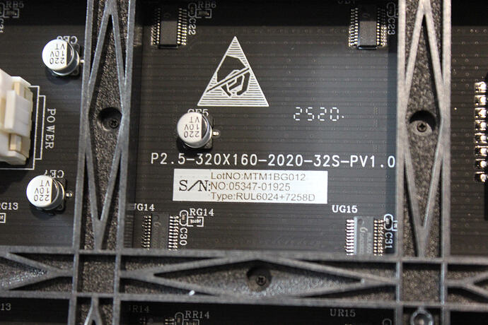

128x64 black stripe panel
Hello everyone!
the panel :

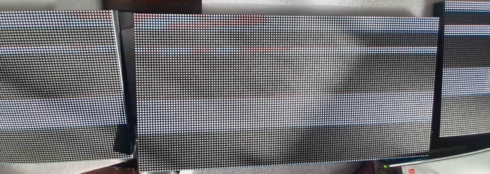

But for images and videos, it displays two black bars on the screens.
I’ve tried extensively, and also with DeepSeek (AI), but I still have the same problem.with this command:
sudo ./led-image-viewer
–led-rows=64
–led-cols=128
–led-chain=3
–led-parallel=1
–led-gpio-mapping=regular
–led-slowdown-gpio=4
–led-no-hardware-pulse
–led-brightness=50
-w5
/home/pi/test_3_panneau.png
the result is:

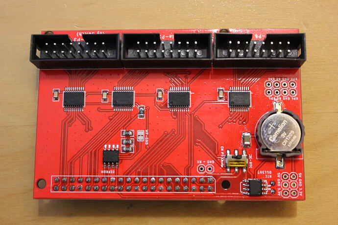

And my shield :
Thanks in advance et good day
If anyone has the same problem, here’s what to do: connect pin 4 to GND and pin 8 to E. The black bars will disappear.
