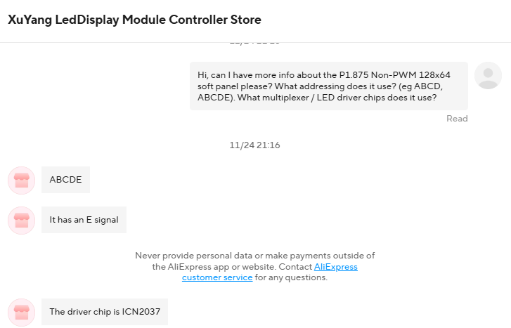

Interestingly, the vendor told me they are ABCDE
He also told me that they are ICN2037 - Is that what yours are?

That exact same vendor on AliExpress said something else:
So either he is wrong, or maybe it has changed since you purchased?
