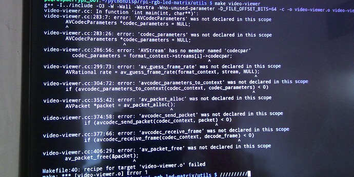

I am trying to play video file on 16*32 P10 led matrix. For this i have following this step to install dependencies:
sudo apt-get update
sudo apt-get install pkg-config libavcodec-dev libavformat-dev libswscale-dev
make video-viewer
but executing command ‘’ make video-viewer ‘’ getting below error:
could anyone suggest is it libav version issue or some other issue?
looks like a library incompatibility.

On my pi3, I see
root@rPi3:~/rpi-rgb-led-matrix/utils# make video-viewer
g++ -I../include -Wall -O3 -g -Wextra -Wno-unused-parameter -D_FILE_OFFSET_BITS=64 -Wno-deprecated-declarations -c -o video-viewer.o video-viewer.cc
make -C ../lib
make[1]: Entering directory '/root/rpi-rgb-led-matrix/lib'
make[1]: Leaving directory '/root/rpi-rgb-led-matrix/lib'
vg++ -Wall -O3 -g -Wextra -Wno-unused-parameter -D_FILE_OFFSET_BITS=64 video-viewer.o -o video-viewer -L../lib -lrgbmatrix -lrt -lm -lpthread `pkg-config --cflags --libs libavcodec libavformat libswscale libavutil`
libs:
ii libavcodec-dev:armhf 7:3.2.14-1~deb9u1+rpt1
ii libavformat-dev:armhf 7:3.2.14-1~deb9u1+rpt1
ii libswscale-dev:armhf 7:3.2.14-1~deb9u1+rpt1
and
root@rPi3:~/rpi-rgb-led-matrix/utils# ldd video-viewer

Yes Marcmarlin. There was library incompatibility.
Thanks
can you post what was wrong and how you fixed it, so that others can benefit?
Hi ,
I had been running Raspbian Jessie OS on my pi3. This OS is not allowing to install the library version which one you have suggested. Due to old version of libs I was getting above error.
When I have updated the OS from Jessie to Stretch, I am able to install latest version of libs and able to make video- viewer.cc file.
oh, good. It must have been a very old version of raspbian. Glad you found a new one.
